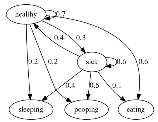

With HMMs, we are however assuming that there is more than meets the eye; there are some hiddens states (latent states), which are unobservable to use. The model keeps track of these and uses them in conjunction with the observables list above to decide how to act - it has the full mapping function. Below is a schematic diagram of such a model:
This just shows several states, along with the probabilities of transitioning to the other states, or stating in the same state. Check out the source for a detailed description of the diagram. One can already imagine sketching this drawing for your problem.
For more on the theory of HMMs, I recommend this text based walkthrough by Jeff Bilmes, and this YouTube series by mathematicalmonk (chapter 14 of the playlist). If you go this route, you might consider trying out the Pomegranate library (in Python).
