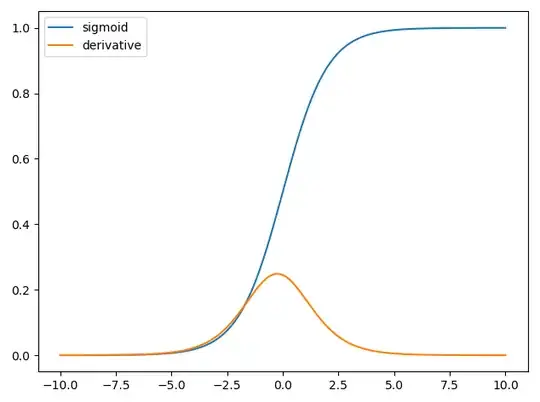

I try to understand role of derivative of sigmoid function in neural networks. enter image description here
First I plot sigmoid function, and derivative of all points from definition using python. What is the role of this derivative exactly? enter image description here
import numpy as np
def sigmoid(x):
    return 1 / (1 + np.exp(-x))
def derivative(x, step):
    return (sigmoid(x+step) - sigmoid(x)) / step
x = np.linspace(-10, 10, 1000)
y1 = sigmoid(x)
y2 = derivative(x, 0.0000000000001)
plt.plot(x, y1, label='sigmoid')
plt.plot(x, y2, label='derivative')
plt.legend(loc='upper left')
plt.show()

During the phase where the neural network generates its prediction, it feeds the input forward through the network. For each layer, the layer's input $X$ goes first through an affine transformation $W \cdot X + b$ and then is passed through the sigmoid function $σ(W \cdot X + b)$.
In order to train the network, the output $\hat y$ is then compared to the expected output (or label) $y$ through a cost function $L(y, \hat y)=L\left(y, σ(W \cdot X + b)\right)$. The goal of the whole training procedure is to minimize that cost function. In order to do that, a technique called gradient descent is performed which calculates how we should change $W$ and $b$ so that the cost reduces.
Gradient Descent requires calculating the derivative of the cost function w.r.t $W$ and $b$. In order to do that we must apply the chain rule, because the derivative we need to calculate is a composition of two functions. As dictated by the chain rule we must calculate the derivative of the sigmoid function.
One of the reasons that the sigmoid function is popular with neural networks, is because its derivative is easy to compute.
In simple words:
Derivative shows neuron's ability to learn on particular input.
For example if input is 0 or 1 or -2, the derivative (the "learning ability") is high and back-propagation will improve neuron's weights for this sample dramatically.
On other hand, if input is 20, the the derivative will be very close to 0. It means that back-propagation on this sample will not "teach" this neuron to produce a better result.

The derivative you see here is important in neural networks. It's the reason why people generally prefer something else such as rectified linear unit.
Do you see the derivative drop for the two ends? What if your network is on the very left side, but it needs to move to the right side? Imagine you're on -10.0 but you want 10.0. The gradient will be too small for your network to converge quickly. We don't want to wait, we want quicker convergence. RLU doesn't have this problem.
We call this problem "Neural Network Saturation".
