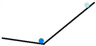

Changing Direction
Now, consider a scenario following the previous one:
After going down the slope (in the previous scenario) for quite some time (i.e. enough time for rmsprop with momentum to reach a nearly constant step size), suddenly a slope with an opposite and smaller constant gradient is reached.
What would happen when we use each of the methods?
scenario 2
This time I would just describe the results of my simulation of the scenario (my Python code is at the end of the answer).
Note that I have chosen for Adam's $\text{BCMA}\left(g_{j}\right)$ a decay factor equal to $\text{momentum_decay_factor}$. Choosing differently would have changed the following results:
  • Adam is slower to change its direction, and then much slower to get back to the minimum.
  • However, rmsprop with momentum reaches much further before it changes direction (when both use the same $\text{learning_rate}$).
    Note that this further reach is because rmsprop with momentum first reaches the opposite slope with much higher speed than Adam. If both reached the opposite slope with the same speed (which would happen if Adam's $\text{learning_rate}$ were $\frac{1}{1-\text{momentum_decay_factor}}$ times as large as that of rmsprop with momentum), then Adam would reach further before changing direction.
