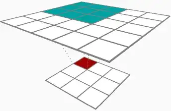

EDIT: To further motivate this, here's an animation of a 3x3 filter applied to a 5x5 input
