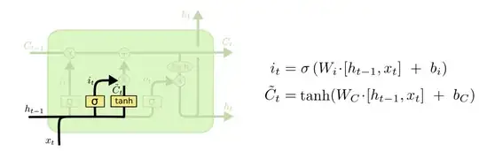

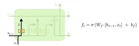

I am trying to understand how the weight matrix in an LSTM cell is used. An LSTM unit has several weight matrix: Wf, Wi, Wc, Wo like below:
( from http://colah.github.io/posts/2015-08-Understanding-LSTMs/ )
At the same time, I am playing with the Keras LSTM and studying its source code: https://github.com/keras-team/keras/blob/master/keras/layers/recurrent.py#L1871
In the source code, there is only one kernel mentioned. I am wondering is it referring to Wc only? Then where are the other weight matrix Wf, Wi, Wo initialized and used? Thanks!

  1. how much information we need to keep track of?
    w_f: guess from the interactions between the previous hidden features and the current input by concatenating both vectors and multiplying them with a weight matrix and applying the sigmoid non-linearity to get values between [0,1] (different for each element) to see how much should we forget from the old cell vector.
    modified_old_cell = old_cell * forgetting_some_dimensions (forget gate f_t).

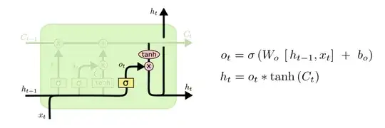

  3. how much information do we need to pass to the next time step, hence if the problem is sequence tagging, maybe some of the output features are only important for the current time step.
    the same mechanism as above:
    current_hidden_features = current_cell * outputting_some_dimensions (output gate o_t).

They use this variable to save all the weight matrices by concatenating them.
In the call function of the LSTMCell you can see, how they are unpacked:
self.kernel_i = self.kernel[:, :self.units]
self.kernel_f = self.kernel[:, self.units: self.units * 2]
self.kernel_c = self.kernel[:, self.units * 2: self.units * 3]
self.kernel_o = self.kernel[:, self.units * 3:]
