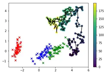

np.random.seed(123)
sampler = GenerativeSampler(model=RFC, X=X, y=y,
                            target_class=2,
                            prior=None,
                            class_err_prob=0.05, # <-- the score we use for candidates that aren't predicted as the target class
                            rw_std=.05,          # <-- controls the step size of the random walk proposal
                            verbose=True,
                            use_empirical=False)
samples, _ = sampler.run_chain(n=5000)
burn = 1000
thin = 20
X_s = pca.transform(samples[burn::thin,:])
# Plot the iris data
col=['r','b','g']
for i in range(3):
    plt.scatter(*X_r[y==i,:].T, c=col[i], marker='x')
plt.plot(*X_s.T, 'k')
plt.scatter(*X_s.T, c=np.arange(X_s.shape[0]))
plt.colorbar()
plt.show()
In this visualization, the x's are the real data, and the class we're interested in is green. The line-connected dots are the samples we drew, and their color corresponds to the order in which they were sampled, with their "thinned" sequence position given by the color bar label on the right.
As you can see, the sampler diverged from the data fairly quickly and then just basically hangs out pretty far away from values of the feature space that correspond to any real observations. Clearly this is a problem.

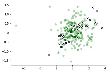

One way we can cheat is to change our proposal function to only allow features to take values that we actually observed in the data. Let's try that and see how that changes the behavior of our result.
np.random.seed(123)
                            target_class=2,
                            prior=None,
                            verbose=True,
                            use_empirical=True) # <-- magic happening under the hood

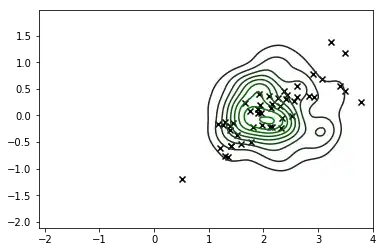

# Constrain attention to just the target class this time
i=2
plt.scatter(*X_r[y==i,:].T, c='k', marker='x')
plt.scatter(*X_s.T, c='g', alpha=0.3)
#plt.colorbar()
plt.show()
sns.kdeplot(X_s, cmap=sns.dark_palette('green', as_cmap=True))
plt.show()
This is definitely a significant improvement and the mode of our distribution corresponds roughly to what we're looking for, but it's clear we're still generating a lot of observations that don't correspond to feasible values of $X$ so we shouldn't really trust this distribution either.

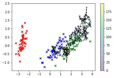

So, having made this insight that we need to incorporate a prior for the data, let's do that by fitting a standard KDE and see how that changes our result.
np.random.seed(123)
                            target_class=2,
                            prior='kde',         # <-- the new hotness
                            rw_std=.05,          # <-- back to the random walk proposal
                            verbose=True,
burn = 1000
thin = 20
col=['r','b','g']
for i in range(3):
plt.plot(*X_s.T, 'k--')
plt.scatter(*X_s.T, c=np.arange(X_s.shape[0]), alpha=0.2)
plt.colorbar()
plt.show()

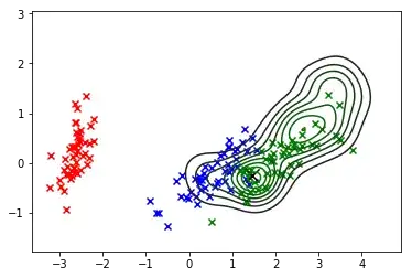

Much better! Now, we can estimate your "optimal" $X$ value using what's called the "maximum a posteriori" estimate, which is a fancy way of saying we fit a second KDE -- but to our samples this time -- and find the value that maximizes the KDE, i.e. the value corresponding to the mode of $P(X|Y)$.
# MAP estimation
from sklearn.neighbors import KernelDensity
from sklearn.model_selection import GridSearchCV
from scipy.optimize import minimize
grid = GridSearchCV(KernelDensity(), {'bandwidth': np.linspace(0.1, 1.0, 30)}, cv=10, refit=True)
kde = grid.fit(samples[burn::thin,:]).best_estimator_
def map_objective(x):
    try:
        score = kde.score_samples(x)
    except ValueError:
        score = kde.score_samples(x.reshape(1,-1))
    return -score
x_map = minimize(map_objective, samples[-1,:].reshape(1,-1)).x
print(x_map)
x_map_r = pca.transform(x_map.reshape(1,-1))[0]
col=['r','b','g']
for i in range(3):
sns.kdeplot(*X_s.T, cmap=sns.dark_palette('green', as_cmap=True))
plt.scatter(x_map_r[0], x_map_r[1], c='k', marker='x', s=150)
plt.show()
And there you have it: the large black 'X' is our MAP estimate (those contours are the KDE of the posterior).
