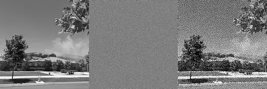

I'm trying to find an optimal dithering pattern which can be used as a threshold on a greyscale image to generate a 1 bit black and white image. Ideally it would be optimal in the sense that a human would judge it perceptually most close to the source image.
For instance, dithering with white noise looks pretty bad:

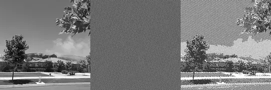

While dithering with blue noise looks a lot better, despite having the same amount of error:
(images from https://blog.demofox.org/2017/10/31/animating-noise-for-integration-over-time/)
While white noise doesn't look good, it can be easily generated in real time, whereas blue noise cannot.
