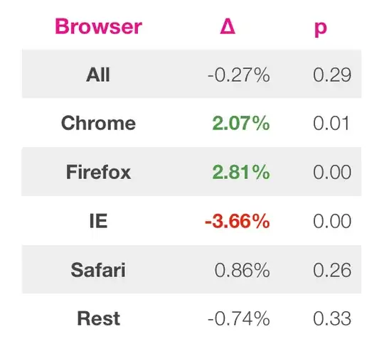

In this case, how do i calculate if the 44% was significant? (while taking into account the multiple comparison problem?) Like in the Airbnb experiment, they did post segmentation analysis on the browser type and was able to calculate the p-value. enter image description here

I recently wrote about this in a blog post. Given this is a rate evaluation metric, you will want to use the z-test. The basic steps are (more details in the blog post)
  1. calculate the pooled standard error of your pairwise comparison
  2. calculate z-statistic by normalizing the delta or lift by the standard error
  3. look up the cdf value of the normalized delta
  4. p-value = 1-cdf(z)
  5. given that this is also an A/B/n test, you should also want to apply multiple testing correction using the bonferroni procedure or the benjamini hochberg procedure, when evaluating significance
Well if you want to answer the question if a single segment reaches the same level and you ignore all other segments behaviors then this should be the required number (given that initial performance of the segments was the same).
As a warning when you use to many segments this: https://xkcd.com/882/ can happen.
