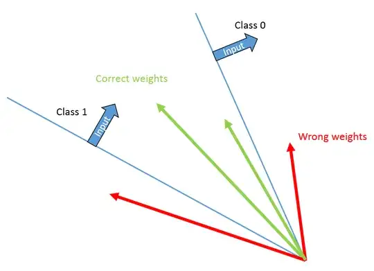

The idea is that in the weight space every input vector is a hyperplane. You need to find a weight vector that is on the correct side of all the hyperplanes of your data inputs. The correct weight therefore is in a convex cone. If you observe a misclassification, that means your weight vector is on the wrong side of the hyperplane and therefore outside the convex cone of possible solutions.
Example of two example input (blue lines) with perpendicular vectors indicating on which side the output is correct

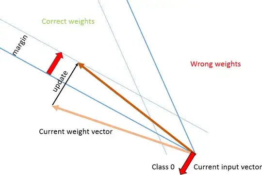

Now, by adding/subtracting the input vector to the weight vector you make sure that this data input vector is now correctly classified. You also make sure, that you decrease the distance of your weight vector by a sufficient margin (at least the length of the input vector) towards the cone of all possible solutions.
Example of a weight update
If you only add parts of the vector (i.e. not update all weights) at each iteration, you cannot be sure that you make sufficient progress or even move in the right direction of the solution space.
