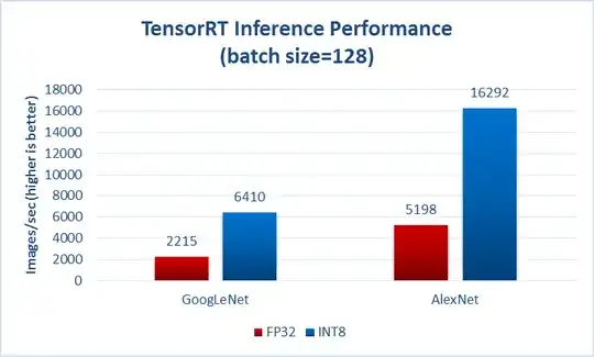

Here an example of benchmark Deep Learning Inference on P40 GPUs (mirror)

Typically they specify somewhere whether they talk about the forward (a.k.a. inference a.k.a. test) time, e.g. from the page you mentioned in your question:

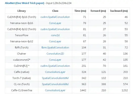

Another example from https://github.com/soumith/convnet-benchmarks (mirror):

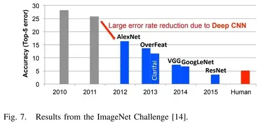

Here is Figure 7 from the paper referenced above, and the associated text:
Figure 7
An excellent example of the successes in deep learning can be illustrated with the ImageNet Challenge $[14]$. This challenge is a contest involving several different components. One of the components is an image classification task where algorithms are given an image and they must identify what is in the image, as shown in Fig. 6. The training set consists of 1.2 million images, each of which is labeled with one of 1000 object categories that the image contains. For the evaluation phase, the algorithm must accurately identify objects in a test set of images, which it hasn’t previously seen.
Fig. 7 shows the performance of the best entrants in the ImageNet contest over a number of years. One sees that the accuracy of the algorithms initially had an error rate of 25% or more. In 2012, a group from the University of Toronto used graphics processing units (GPUs) for their high compute capability and a deep neural network approach, named AlexNet, and dropped the error rate by approximately 10% $[3]$.
Their accomplishment inspired an outpouring of deep learning style algorithms that have resulted in a steady stream of improvements.
In conjunction with the trend to deep learning approaches for the ImageNet Challenge, there has been a corresponding increase in the number of entrants using GPUs. From 2012 when only 4 entrants used GPUs to 2014 when almost all the entrants (110) were using them. This reflects the almost complete switch from traditional computer vision approaches to deep learning-based approaches for the competition.
In 2015, the ImageNet winning entry, ResNet $[15]$, exceeded human-level accuracy with a top-5 error rate4 below 5%. Since then, the error rate has dropped below 3% and more focus is now being placed on more challenging components of the competition, such as object detection and localization. These successes are clearly a contributing factor to the wide range of applications to which DNNs are being applied.
