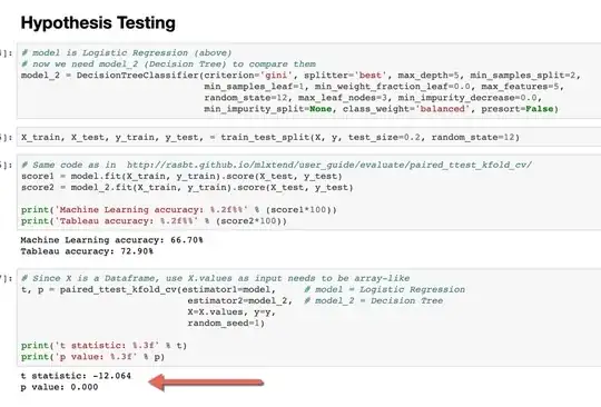

I'm not sure if this helps, but did you know that you can COMPARE two ML models?
It's an API created by Sebastian Raschka (author of "Machine Learning with Python").
I find it very cool.
http://rasbt.github.io/mlxtend/ enter image description here
