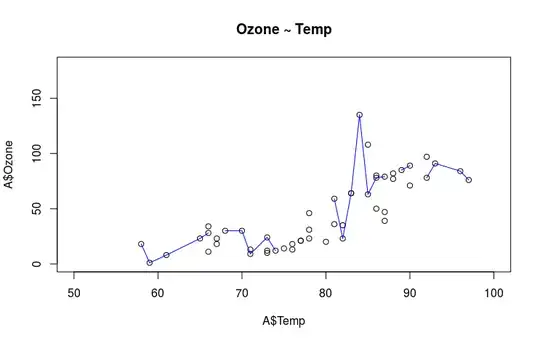

plot(x = A$Temp, y = A$Ozone, type = "p", main = "Ozone ~ Temp",
     xlim = c(50, 100), ylim = c(0, 180))
lines(lowess(x = A$Temp, y = A$Ozone), col = "blue")
Scatter plot: Ozone ~ Temp for set A

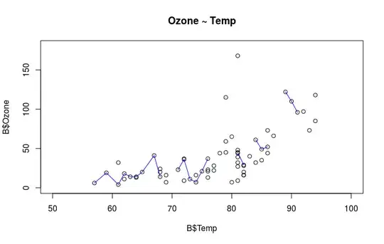

plot(x = B$Temp, y = B$Ozone, type = "p", main = "Ozone ~ Temp",
lines(lowess(x = B$Temp, y = B$Ozone), col = "blue")
Scatterplot: Ozone ~ Temp for set B
cor(x = A$Temp, y = A$Ozone, method = "spearman", use = "complete.obs") ## [1] 0.8285805
cor(x = B$Temp, y = B$Ozone, method = "spearman", use = "complete.obs") ## [1] 0.6924934
