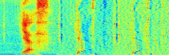

I am currently working on recreating the results of this paper. In the paper they describe a method for using CNN for features extraction, and have a acoustic model that is Dnn-hmm and pretrained using RBM.
Section III subsection A states different ways the input data can be represented. I decided to vertically stack the spectrum plots of the static, delta and delta deltas.
So as such: enter image description here
