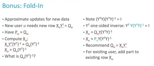

Lots of questions here. First, for a truly new user with no data, there is no way to use a recommender model. If you have literally no information on the user, the only thing you can do is provide some default recommendations.
Of course, once you have any data, and you can rebuild the model to incorporate the user, you can make recommendations. You can do that in Spark but you already know that. This will take too long if you need to add information about new users at runtime. The technique you want is called "fold-in", used to figure out what the new user vector is (approximately) given the items the user interacts with. It's just some linear algebra and does follow from the equation you give.
I dug out an old slide which might help:
ALS Fold-In
The "Cu" is not really different. I added an 'extension' to handle the case of negative input, but it's the same for positive input.
Here's an implementation of fold-in, although I think it's going to be too dense to be of much value:
https://github.com/OryxProject/oryx/blob/2c01d496f93f2825a076eb7fe492aa39a5290aa6/app/oryx-app-common/src/main/java/com/cloudera/oryx/app/als/ALSUtils.java#L74
Computing the new user vector implied by a user-item interaction is fairly easy linear algebra. The tricky part I've found is deciding how much to weight it.
Hope that is a push in the right direction.
