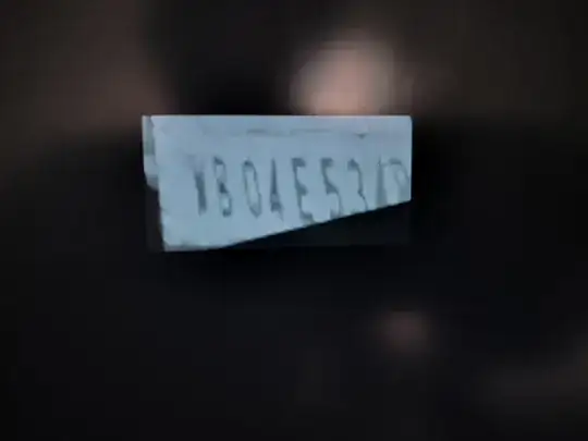

My requirement: Need to extract license plates without duplicates and store images in a folder,then apply ocr to extract text from images.
What i have achieved: Iam able to detect license plates properly and with the help of tracking mechanism i was able to avoid dupicate plates.
Pending item: Unable to format image properly which is causing ocr unable to read text
I have created below code which will detect license plates from vehicles and store images in a folder and ocr them to get text in to a separate file,In my case image which is being stored in folder is not straightening/cropping properly after processing and even image is looking dull,Because of this ocr is not recognizing text properly.Please help me resolve this,once ocr recognizes text from image my work is done
license_plate_after_processing license_plate_detected
