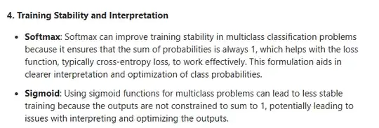

Training model for multiclass with SoftMax - the training is more stable vs training with sigmoid
  • Why is it true ?
  • Is it easier to train model (and get better results) with SoftMax (instead of sigmoid) ?

The short answer is: Yes, it is easier to train a model using SoftMax for multiclass classification compared to sigmoid, and SoftMax generally yields better results (lower loss and higher accuracy).
1. SoftMax is Designed for Multiclass Classification
SoftMax produces a normalised probability distribution across all classes, ensuring:
  • All outputs are constrained between 0 and 1.
  • The probabilities for all classes sum to 1.
This meets the requirements of multiclass classification, where each instance belongs to exactly one class. Sigmoid, by contrast, assigns independent probabilities to each class without ensuring mutual exclusivity, making it unsuitable for multiclass problems.
2. Loss Function Compatibility
SoftMax works naturally with the cross-entropy loss function, the standard for classification tasks. Cross-entropy measures the distance between the predicted probability distribution (from SoftMax) and the true distribution (one-hot encoded labels). This compatibility ensures smooth optimisation and convergence.
Sigmoid, when applied independently to each class, does not account for relationships between class probabilities. Using sigmoid for multiclass classification with cross-entropy introduces instability, as the loss function does not properly enforce the mutual exclusivity of classes.
3. Training Stability
SoftMax ensures smoother gradients during optimisation:
  • The normalisation step reduces the likelihood of vanishing or exploding gradients.
  • It allows the optimiser to update parameters in a way that respects the probabilistic structure of the output space.
In contrast, sigmoid’s independent probabilities can lead to conflicting gradient signals during training, especially in multiclass problems, causing slower convergence or unstable training dynamics.
4. Empirical Evidence
In practice, models using SoftMax with cross-entropy loss for multiclass classification converge faster and achieve better accuracy compared to models using sigmoid. The normalisation and alignment with the problem’s structure make SoftMax a more effective choice.
