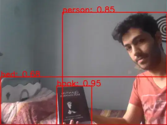

I snapped a photo of me holding a book, which you can see below:
It works perfectly well on my laptop in real-time (30 FPS), which I consider to be pretty good.
