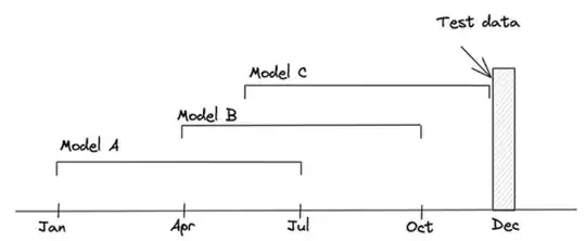

Is there any way to determine the period/frequency of re-training a model before the predictions begin to degrade?
One way to figure out the gain is by training your model on the data from different time windows in the past and evaluating it on the data from today to see how the performance changes. enter image description here
You decide the frequency based on the performance results.
