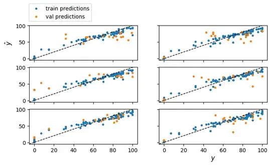

I had a go at processing the data and fitting a random forest.
My steps were:
  • Drop columns: DOI, Amino group
  • Drop rows with no y value
  • Convert strings to numbers, and one-hot encode Ligand column
  • Put a test set aside (shuffling & stratified sampling was used)
  • Impute missing categorical rows, and missing numerical values
These steps were encapsulated in a pipeline that allows for full separation of train-validation data during CV.
I ran KFold CV and got a median $R^2$ of 0.57.
One of the folds had a negative (close to zero) $R^2$. I ran CV again, but this time recording all of the predictions and plotting them for each of the 6 folds:
The model seems to learn the training set well, but generalise relatively poorly. The fold with the lowest score (first plot) had relatively few values at the lower end, and was variable at the upper end. Even though it had a low $R^2$, its RMSE of 20 was as good as most other folds. The folds generally had flat-looking test predictions apart from at y=0 - is y=0 a valid value?

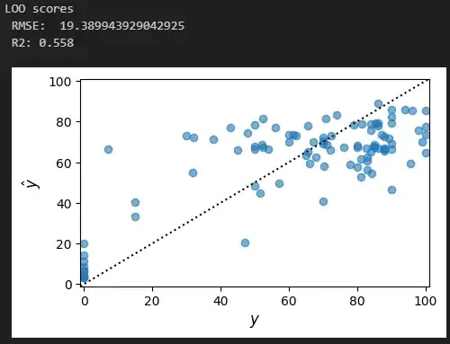

I finally ran leave-one-out CV to see how well it predicts individual samples when trained on the rest of the data.
To me it seems like the model isn't too good at rendering predictions from these features. I think the $R^2$ could be skewed by the y=0 entries. I then deleted the y=0 rows and re-ran the CV, finding that the score dropped to 0.15.
The bad predictions might be a data issue. Values beyond y=0 the model doesn't make good predictions. Also, tuning of the RF didn't yield significant improvement. sklearn.ensemble.GradientBoostingRegressor did a bit better. But I think one ought to try a wider range of models before drawing a definitive conclusion as to whether it's a data problem vs. model problem.
