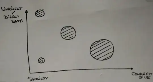

  • Collecting the data is now easier as it is a implied by the previous task. However, classify mentally your data in the following graph to know what to start with according to your personal trade-off: enter image description here
    1. Direct data are those that can be obtained easily. Indirect are those that require some pre-process (scrapping websites, cropping images, counting number of clicks, ...)
    2. The simplicity / complexity of use depends on the data : generally speaking, structured data within arrays are easier to deal with that images.
    3. The size of the dot is the reward obtained if you achieve to work on these data, regarding your whole project
