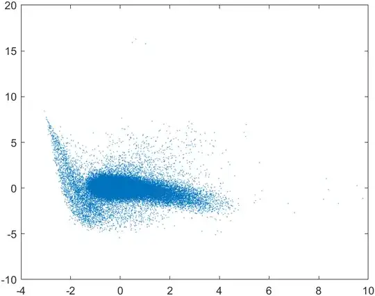

Here is the data: data

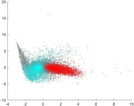

Here is the typical result of gustafson-kessel and gath-geva gath-geva result

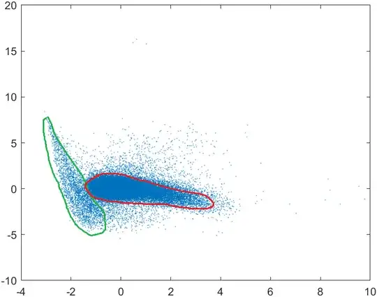

The desired result would be some thing like this: ( i know that because these groups represent different physical processes and we can realize that by eye) desired result
Can someone help me with this please? The data is attached here data.
The Problem is that many clustering algorithms focus on distances (between points, clusters and so on). Especially at the connection between the two desired clusters, distances between points are small. There is little to know clue from these distances that there should be a change in clusters.
But we why can see the two clusters?
  1. There is a change in density at the connection point between the desired clusters.
  2. The clusters resemble comets with their tails and the human eye focuses on such patterns.
