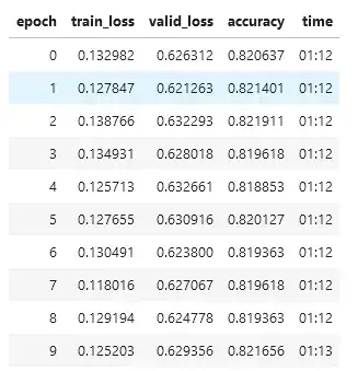

I'm playing around with CNN in FastAI.
My model with 2 millions parameters only has around 80% accuracy. I also tried with Data normalization, Batch normalization, Label smoothing, Mixup but the results are still capped at 80-81% (they did converged faster with those techniques).
I assumed bigger model would make better predictions so I increase the parameters (from 2 millions to 182 millions). However, the result is still at 82% after 40 epochs

test_model.fit_one_cycle(10, 0.00015)
Result after 40 epochs

  1. You can try more architectures such as ResNets, U-Nets, Inception Networks.
  2. You also need to perform some more hyperparameter tuning check out some tools for tuning your models
