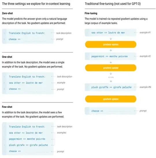

Recent models like the GPT-3 Language Model (Brown et al., 2020) and the Flamingo Visual-Language Model (Alayrac et al., 2022) use in-context few-shot learning. The models are able to make highly accurate predictions even when only presented with a "few" support examples. See diagram below (from Brown et al., 2020).
Yet, it is unclear to me how these models theoretically work behind the scenes, and why they perform so well. The explanation appears to be that few-shot learning works because the model looks at the task description, then looks at the support examples (which are successful examples of how the given task can be fulfilled), and then based on the model's understanding of what the assigned task is and its understanding of the examples given of how the task could be successfully fulfilled it is then able to understand what it is supposed to predict based on the prompt.
Generally speaking, the more support examples the model sees at inference time, the better it will perform (but there is a point at which continuing to add further support examples does not increase performance). However, given that traditional machine learning models need to train on thousands of examples, it would seem unlikely that a model could really fulfill a task just based on a few examples.

I highly recommend you read Microsoft's recent paper about In Context Learning. Although the focus is on LLM I think it can be generalised to other models.
The idea is to consider models as mesa|meta-optimisers (optimisers at inference time).
They approximately show that the model performs implicit gradient descent (and thus implicit fine-tuning) at inference time. Obviously, the gradient descent doesn't modify the models' weights, but it modifies the attention mechanism (as would fine-tuning by modifying the weights).
