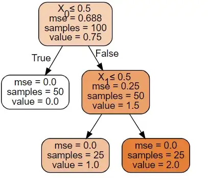

I've been trying to understand the math behind shap values. So far I understand all the concepts in SHAP but not to get to the shap values that are in this example (coming from the last example of https://shap.readthedocs.io/en/latest/example_notebooks/tabular_examples/tree_based_models/Understanding%20Tree%20SHAP%20for%20Simple%20Models.html ).
What I've got so far is : Assume you have to explain an observation where x0=0,x1=0,x2=0,x3=0. So x is a vector of zeros for this case. Since we know x2 and x3 are NOT in the tree we wont do any calculation with them (if it is a GBM tree based model, simply parse if the variable is in any of the trees of the ensemble). To proove this is correct just calculate shap without this values or with a vector of 100 zeros, shap importances greater than 0 won't change (x0 and x1 and local accuracy property will stil hold (local accuracy means "sum of contributions + expected value = predicted output ).
Calculate all possible expected values in the tree (remember that the predicted values with a set of features for the tree is the expected value conditioned on the features).
STEP 1 EXPECTED VALUES: Expected values (not conditioned and conditioned)
E(y) = 0.75
E(y|x0=0) = 0
E(y|x0=0,x1=0) = 0
E(y|x1=0)=0 * 0.5+ 0.5 * 1.0=0.5
STEP 2: Now calculate contributions
contribution_adding_x0_to_null_model= E(y|x0=0) - E(y) = 0 - 0.75 = -0.75
contribution_having_x1_to_null_model = E(y|x1=0) - E(y) =0.5 - 0.75 = -0.25
contribution_adding_x0_to_x1= E(y|x0=0,x1=0) - E(y|x1=0) = 0 - 0.5 = -0.5
contribution_adding_x1_to_x0 = E(y|x0=0,x1=0) - E(y|x0=0) = 0 - 0 = 0
This would be the average of all possible combinations (superset) of having this feature and not having that?
** UPDATE 2 **, correct calculation
shap_x0 = mean (contribution_adding_x0_to_null_model , contribution_adding_x0_to_x1 ) = mean(-0.75,-0.5) = (-0.75-0.5)/2=-0.675
shap_x1 = mean( contribution_adding_x1_to_null_model, contribution_adding_x1_to_x0 ) = mean(-0.25,0)=-0.125
Proof this is correct, see shap package output bellow and also (local accuracy):
Prediction when all x are zeros (see the tree leaf in the left)
prediction = E(y|x0=0,x1=0,x2=0,x3=0) = 0
shap_x1+shap_x0+expected_value = -0.125-0.675+0.75=0=prediction
What am I forgetting about? [DONE]
Code for generating the tree:
# build data
N = 100
M = 4
X = np.zeros((N,M))
X.shape
y = np.zeros(N)
X[:N//2, 0] = 1
X[:1 * N//4, 1] = 1
X[N//2:3 * N//4, 1] = 1
y[:1 * N//4] = 1
y[:N//2] += 1
fit model
and_fb_model = sklearn.tree.DecisionTreeRegressor(max_depth=2) and_fb_model.fit(X, y)
draw model
dot_data = sklearn.tree.export_graphviz(and_fb_model, out_file=None, filled=True, rounded=True, special_characters=True) graph = graphviz.Source(dot_data) graph
Explain the model for all zeros or all ones:
xs = [np.ones(M), np.zeros(M)]
for x in xs:
    print()
    print("          x =", x)
    print("shap_values =", shap.TreeExplainer(and_fb_model).shap_values(x))
>>> Output of this code is:
>>> x = [1. 1. 1. 1.] >>> shap_values = [0.875 0.375 0. 0. ]
--- THIS ONE IS THE CASE OF THE EXAMPLE I GAVE, x is a vector of zeros: x=(x0,x1,x2,x3) =(0,0,0,0) >>> x = [0. 0. 0. 0.] >>> shap_values = [-0.625 -0.125 0. 0. ]
Thanks in advance!
UPDATE 3: Additional if anyone is interested: SOLUTION WHEN vector x = (1,1,1,1)
STEP1 EXPECTATIONS
E(y) = 0.75
E(y|x0=1) = 1.5
E(y|x0=1,x1=1) = 2
E(y|x1=1)= 0.5*0 + 0.5+2 = 1.0
STEP2 Contributions
contribution_adding_x0_to_null_model = E(y|x0=1) - E(y) = 1.5 - 0.75 = 0.75
contribution_having_x1_to_null_model = E(y|x1=1) - E(y) = 1.0 - 0.75 = 0.25
contribution_adding_x0_to_x1 = E(y|x0=1,x1=1) - E(y|x1=1) = 2 - 1.0 = 1.0
contribution_adding_x1_to_x0 = E(y|x0=1,x1=1) - E(y|x0=1) = 2-1.5=0.5
shap_x0 = mean(contribution_adding_x0_to_null_model,contribution_adding_x0_to_x1) = mean(0.75,1.0)=0.875
shap_x1 = mean(contribution_having_x1_to_null_model,contribution_adding_x1_to_x0) = mean(0.25,0.5)=0.375
STEP 4: Check local accuracy property:
When x=1 , the prediction is:
prediction = 2.0
The sum of shap values is:
shap_x0 +shap_x1 + expected_value = 0.875+0.375+0.75=2.0
It definitely hodls.

You seem to have entirely the right idea, you just miscalculated the second and fourth contributions you listed. Below are the corrected calculations, bolded to indicate where a change has been made:
contribution_having_x0 = E(y|x0=0) - E(y) = 0 - 0.75 = -0.75
contribution_having_x1 = E(y|x1=0) - E(y) = 0.5 - 0.75 = -0.25
contribution_adding_x0_to_x1 = E(y|x0=0,x1=0) - E(y|x1=0) = 0 - 0.5 = -0.5
After this, averaging the two contributions when adding a feature gives the same shap values as reported by the package. (The mistake in the formula for the second equation gives rise to your mistaken simplification of it.)
