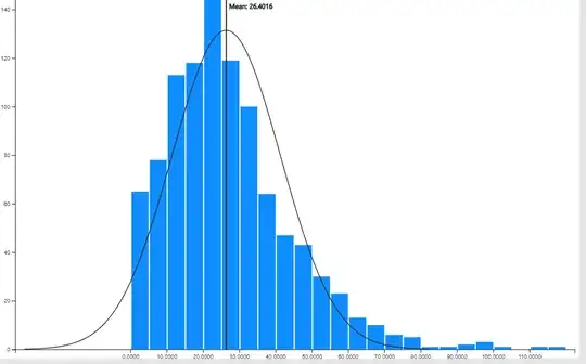

The data is not exactly normally distributed and infact doesn't really fit any distribution (Here is the histogram for total faults per tool id for a given time frame) -
What is the appropriate model to use for such a problem and the best approach to start working on this?

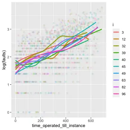

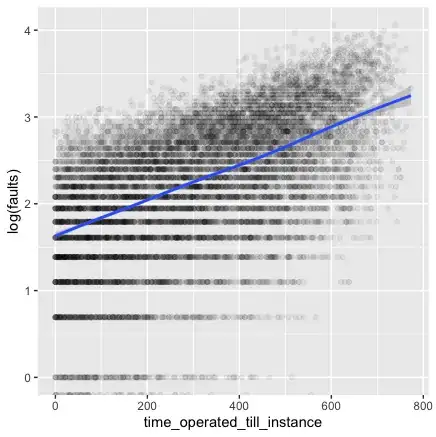

session_dat %>% ggplot(aes(time_operated_till_instance, log(faults))) + geom_point(alpha = 0.05) + stat_smooth()
session_dat %>% filter(i %in% sample(i, 10)) %>%
  ggplot(aes(time_operated_till_instance, log(faults), color = i)) +
  geom_point(alpha = 0.1) + stat_smooth(se = F)

If you look at the coefficient for time_operated_till_instance
you'll see it's pretty close to beta_t. The other betas are wobly,
but could be used as a somewhat noisy estimate of the tools quality.
