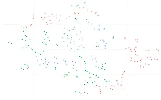

For example, I'm applying T-SNE to rather-high dimensional data (40 features) and obtaining this representation:
Disregarding the colors you observe in the picture, I would like to apply a clustering algorithm and separate the data from the found clusters (let's say 6 or 7 clusters), and then analyze the characteristics of each cluster using the high-dimensional representation of each point.
This is in synthesis: using the low dimensional to find clusters, and analyze (exploration) each cluster separately using the high dimensional representation. If I'm not able to do this, I don't see the actual point of visualizing in the low-dimensional space, in a practical sense.
I understand T-SNE preserves well local structures and less accurately global structures, is this a drawback to do why I want? Is this low-dim clustering approach more suitable for other manifold learning methods?
EDIT: Probably a more direct way of asking this is: Can I use observed clusters in low dimensional representation to label or tag examples, and use these labels for discrimination using the original high dimensional representation?

You can do anything you want in the low dimensional space, and can try to validate as well. By clustering the above, you are in effect assigning features/tags to your data points in higher dimensions. Remember, tSNE tries to preserve distances, so that points in high dimensions will remain close to each other in low dimensions.
With that in mind, don't forget that no two instances of tSNE will be the same, which means that your clustering centers will be different each time you run tSNE.
