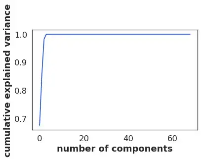

Now I tried doing PCA and I got this:
pca = PCA().fit(transformedData)
print(pca.explained_variance_ratio_.cumsum())
plt.plot(pca.explained_variance_ratio_.cumsum()) plt.xlabel('number of components') plt.ylabel('cumulative explained variance')
the output of this PCA is the following:
[0.67454179 0.8541084  0.98180307 0.99979932 0.99986346 0.9999237
 0.99997091 0.99997985 0.99998547 0.99999044 0.99999463 0.99999719
 0.99999791 0.99999854 0.99999909 0.99999961 0.99999977 0.99999988
 0.99999994 0.99999998 0.99999999 1.         1.         1.
 1.         1.         1.         1.         1.         1.
 1.         1.         1.         1.         1.         1.
 1.         1.         1.         1.         1.         1.
 1.         1.         1.         1.         1.         1.
 1.         1.         1.         1.         1.         1.
 1.         1.         1.         1.         1.         1.
 1.         1.         1.         1.         1.         1.
 1.         1.         1.        ]
PCA1

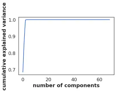

Then I tried:
pca = PCA().fit(withoutOutliers)
out:
[0.68447278 0.86982875 0.99806386 0.99983727 0.99989606 0.99994353
 0.99997769 0.99998454 0.99998928 0.99999299 0.9999958  0.99999775
 0.99999842 0.99999894 0.99999932 0.99999963 0.9999998  0.9999999
 1.         1.         1.         1.         1.         1.
 1.         1.         1.         1.         1.         1.
 1.         1.         1.         1.         1.         1.
 1.         1.         1.         1.         1.         1.
 1.         1.         1.         1.         1.         1.
 1.         1.         1.         1.         1.         1.
 1.         1.         1.         1.         1.         1.
 1.         1.         1.        ]
PCA2

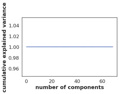

Finally:
pca = PCA().fit(normalizedData)
Out:
[1. 1. 1. 1. 1. 1. 1. 1. 1. 1. 1. 1. 1. 1. 1. 1. 1. 1. 1. 1. 1. 1. 1. 1.
 1. 1. 1. 1. 1. 1. 1. 1. 1. 1. 1. 1. 1. 1. 1. 1. 1. 1. 1. 1. 1.]
PCA3
How is it possible that the last execution gives such an output?

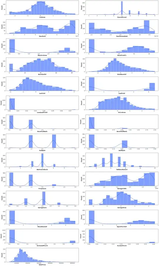

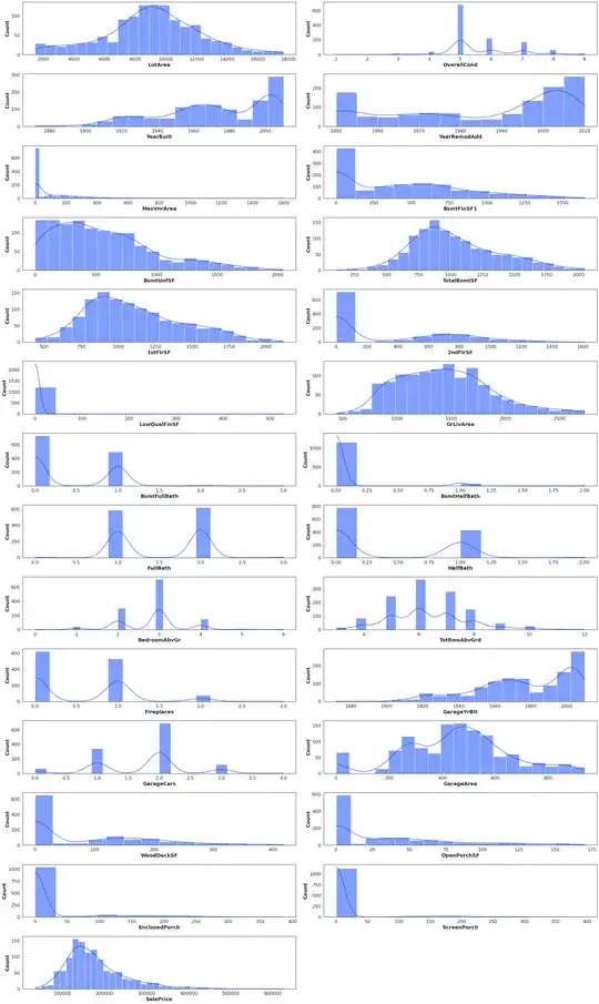

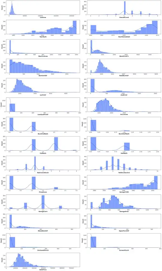

Here are data distributions
transformedData
transformedData hist
withoutOutliers
withoutOutliers hist
normalizedData
normalizedData hist
