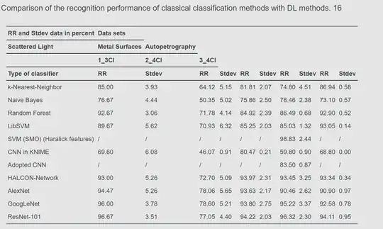

  2. Paper on industrial recognition tasks: for small amounts of training data, classical classifiers provided better performance to not pre-trained neural networks

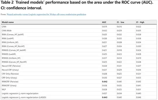

  3. Paper on Heart Failure: compares performance of deep learning versus logistic regression

RESOURCE 2 - Research paper on industrial recognition tasks
Comparison of the performance of innovative deep learning and classical methods of machine learning to solve industrial recognition tasks
Comparisons were made using the recognition rates achieved with five real data sets from industrial applications. The results showed that not pre-trained neural networks produce worse results than classical classifiers with the given small amounts of data for training.
Deep neural networks require an extremely large amount of data for training in order to develop a good generalization capability and thus deliver good results
Even if many training objects are available, deep neural networks remain susceptible to overfitting. Due to the large amount of data to be processed, the training also takes up a lot of time and can take days or even weeks 10. Very high computing power is required for the effective use of these methods 22. For this reason, such applications should be processed by the Graphics Processing Unit (GPU) instead of the Central Processing Unit (CPU) for saving time 10. In addition, many parameters have to be set and optimized, e.g. initial weights, activation function, learning rate, batch size 23. According to Bengio 21, the quality of the results depends on the initial values.Since neural networks are black boxes, the decision-making process is not user-comprehensible.

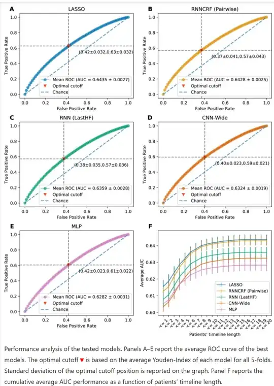

Neural networks Vs Logistic regression, 30 days all-cause readmission prediction
The question of deep learning versus logistic regression for readmission prediction for Heart Failure, shows that logistic regression with regularization matches the best neural network performance. AUC Comparision

  6. Neural networks versus Logistic regression for 30 days all-cause readmission prediction
