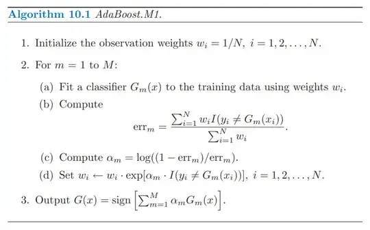

The AdaBoost algorithm is:
My trouble is how the classifier $G_m(x)$ is trained, What does mean a classifier to be trained using weights $w_i$? Is it to fit classifier through $\{w_i,y_i\}_{i=1}^{N}$?

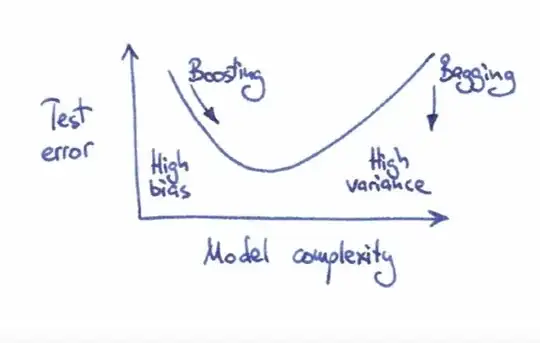

Adaboost is a model (ensemble) that starts with high bias but low variance, in contrast with bagging ensembles that are models with a high variance but low variance (see fig 1.)
figure 1

The weights refers to the weights assigned to misclassified samples. Adaboost assigns weights to each misclassified observations based on the calculation showed above. When it trains boosting model this weights help model to give more importance to misclassified observations

In the context of AdaBoost.M1 (also known as Discrete AdaBoost), the base classifier returns a discrete class label, usually $1$ or $-1$.
When the base classifier is a classification tree, the CART algorithm can handle sample weights after minor modifications described next.
For the sake of generality and consistency with the source code of scikit-learn, let us consider multiclass classification with labels $1,\ldots,C$ (instead of just binary classification). Assume weights $w_1,\ldots,w_n$ are assigned to each observation in the training sample.
Recall that the optimal split of a node $A$ is found by minimizing the weighted sum of the impurities in the left- and right- child $$\frac{n_{A_{\text{left}}}}{n_A} H(A_{\text{left}}) + \frac{n_{A_{\text{right}}}}{n_A} H(A_{\text{right}}).$$ Let $\hat \eta_{1},\ldots,\hat \eta_{C}$ denote the class-probability estimates for node $A$. Usual choices for the node impurity are $$H(A) = \begin{cases} 1-\max_{1\leq c\leq C} \hat \eta_{c} \quad &\text{Classification error rate} \\ \sum_{c=1}^{C} \hat \eta_{c}(1-\hat \eta_{c}) \quad &\text{Gini index} \\ -\sum_{c=1}^{C} \hat \eta_{c}\ln \hat \eta_{c} \quad &\text{Entropy} \end{cases}$$ With samples weights, these formulas for impurity remain the same, only the way $\hat\eta_c$ is computed changes.
  • Without sample weights, the definition of $\hat\eta_c$ is $$\hat\eta_c = \frac{|\{i:x_i\in A \text{ and } y_i=c\}|}{n_A}.$$
  • With sample weights, define $S=\sum\limits_{\substack{1\leqslant i\leqslant n,\\x_i\in A}} w_i$ and $\hat\eta_c$ is now $$\hat\eta_c = \frac 1S \sum\limits_{\substack{1\leqslant i\leqslant n,\\x_i\in A \text{ and } y_i=c }} w_i = \frac 1S\sum_{i=1}^n w_i 1_{x_i\in A \text{ and } y_i=c}.$$
