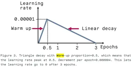

  1. Warm up steps: Its used to indicate set of training steps with very low learning rate
  2. Warm up proportion ($wu$): Its the proportion of number of warmup steps to the total number of steps 3 Selecting the number of warmup steps varies depending on each case.
    • This research paper discusses warmup steps with 0%, 2%, 4%, and 6%, which are all reflect significantly fewer warmup steps than in BERT.
    • This particular user had better performance with warmup steps of 165k. Kindly refer to this forum
  3. As per this deep-learning documentation its warmup per epoch

a) Warm-up: A phase in the beginning of your neural network training where you start with a learning rate much smaller than your "initial" learning rate and then increase it over a few iterations or epochs until it reaches that "initial" learning rate.
Another nice explanation. This one also has an example code and graph.
Warmup is a method of warming up learning rate mentioned in ResNet paper. At the beginning of training, it uses a small learning rate to train some epoches or steps (for example, 4 epochs, 10000 steps), and then modifies it to the preset learning for training.
