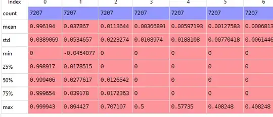

If I look at my rescaled data, it looks as I would expect it to look.
df.describe of rescaled data
