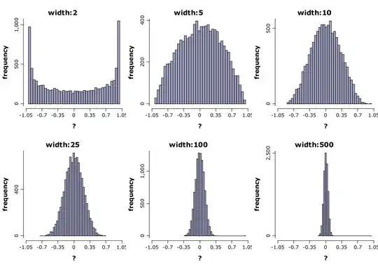

First of all I don't have sentences and anyway I don't use Python, so I generated artificial data (vectors with random values from a standard normal) in a matrix with rows being the instance vectors to be compared via cosine similarity. I noticed an interesting phenomena: on average the cosine similarity between random vectors have a shorter range of absolute values as the lengths of the vectors increases.
sampled cosine similarity vs random vectors size
In the graph above we can see that for small vector sizes the empirical distribution covers the whole range $[-1,1]$, and this range shrinks as vector sizes grows. This is important because the role of the pooling layers is to reduce the size of input vectors while retaining important information. As a consequence, if the pooling is aggressive the range of cosine similarity will increase on average. This is what @albus_c noticed, I think.

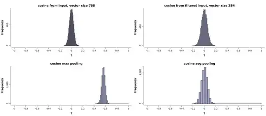

I also implemented a 2D pooling layer function over the random sample with average and max pooling. What I noticed, contrary to my intuition, is that averaging does not decrease the range of cosine, but keeps it in the same range. Due to the previous effect, however (pooling shrinks vector sizes and increase the range of cosine as a consequence) the final effect is that the cosine range is increased. In the case of max pooling, however, the cosine range is shrinked and moved drastically to positive values, as can be seen in the below graph.
cosine before and after pooling
In the graph above we can see in the upper left the histogram of cosine similarities on random vectors of size $768$. On upper right histogram we have cosine similarities only for vectors of size $384$ for comparison. I applied a 2d pooling layer with size $2$ and slide $2$. In the lower left graph we have similarities after max pooling. We clearly observe the values moving towards $1$ in positive range. In the lower right we have similarities after mean pooling. We notice the range has increased compared to original (upper left) but is similar with the range onvectors of same size (upper right).
I did not worked out an analytic explanation for that, those are only simulations. The normal shape that appears is due to how I generated data, in real life it can look different, but I expect tendencies to remain the same. I have also experimented with different sizes of pooling. If the size of the pooling patch increases the effects increases dramatically on max pooling while remaining the same for averaging. If the slide of the pooling is lower than the size of the patch (the patches overlap) a correlation appears between resulted vectors and the cosine range shrinks more due to that correlation for both max and average pooling.
