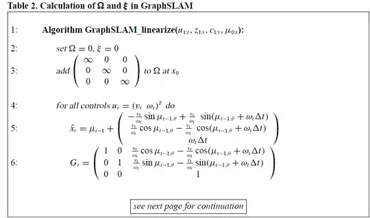

I am trying to implement Graph slam. I have some doubts regrading implementation. I attached a picture to clarify my doubt.
[enter image description here
I have a doubt in line number 2. It show omega have a scalar value 0. But at line 3 it show omega is a Matrix.

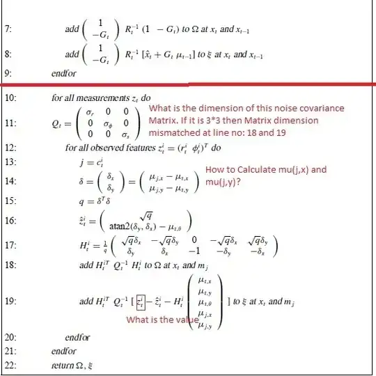

Next doubt at line 7. In this line omega which is a 3*3 matrix is add with a 6*6 matrix. As per my knowledge it is impossible.

Often we use $0$ to represent the all-zeros matrix, so the instruction to set $\Omega = 0$ might mean to set it to the all-zeros matrix (with a zero in every entry). You'll have to figure out from context whether that seems correct.
