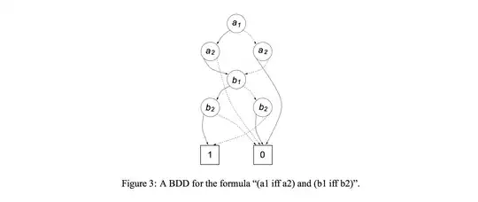

  1. How to compute (at a high level) the set $\{s \in S \mid \mathcal{M},s \vDash \varphi \}$, using $\mathbf{EX}\alpha$ as an example. Perhaps using their example of $(a_1 \leftrightarrow a_2) \land (b_1 \leftrightarrow b_2)$ as the boolean expression for state (image below), or a different one, whatever's easier.

The first model checking algorithms used an explicit representation of the Kripke structure as a labeled, directed graph [23, 28, 51].$^3$ A major improvement was achieved with the use of symbolic representations [29, 49, 59, 12, 47], based on the use of Ordered Binary Decision Diagrams [7, 8] (BDDs for short). BDDs are a representation for boolean formulas, which is canonical once an order on the variables has been established. Figure 3 [below] depicts the BDD for the boolean formula $(a_1 \leftrightarrow a_2) \land (b_1 \leftrightarrow b_2)$, using the variable ordering $a_1, a_2, b_1, b_2$. Solid lines represent “then” arcs (the corresponding variable has to be considered positive), dashed lines represent “else” arcs (the corresponding variable has to be considered negative). Paths from the root to the node labeled with “1” represent the satisfying assignments of the represented boolean formula (e.g., $a_1 \leftarrow 1$, $a_2 \leftarrow 1$, $b_1 \leftarrow 0$, $b_2 \leftarrow 0$). Intuitively, a state of the system is symbolically represented by an assignment of boolean values to the set of state variables.$^4$ A boolean formula (and thus its BDD) is a compact representation of the set of the states represented by the assignments which make the formula true. Similarly, the transition relation can be expressed as a boolean formula in two sets of variables, one relative to the current state and the other relative to the next state.
