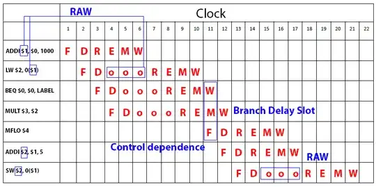

I'm confused about this exercise.
We have assembly code:
01: ADDI $1, $0, 1000
02: LW   $2, 0($1)
03: BEQ  $0, $0, LABEL
04: MULT $3, $2
05: ADDI $2, $2, 1000
LABEL:
06: MFLO $4
07: ADDI $2, $1, 5
08: SW   $2, 0($1)
09: NOP
with:
- 6-stages Pipeline
- Branch Delay Slot
- No Bypassing
Is this correct?
Does the Instruction in Branch Delay Slot effect on/by the others Instructions. For example here:
02: LW \$2, 0(\$1) and 04: MULT \$3, \$2
04: MULT \$3, \$2 and 06: MFLO \$4
