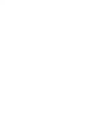

As an example,consider the example set cover instance given on Wikipedia, namely $\{1,2,3,4,5\}$ and sets $S=\{\{1,2,3\},\{2,4\},\{3,4\},\{4,5\}\}$. This translates to the following graph:
example
