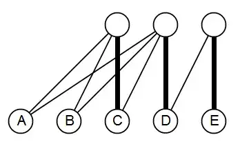

In a previous version of this answer, I had neglected case 2), assuming that it was somehow covered during the proof of Lemma 1. However, this is not the case. There can exist minimal, deficient sets which do not look like $D_u$. The following diagram shows such an example. Taking the bolded edges as the matching $M$, we can see that $S = \{A, B, C\}$ is a minimal, deficient set and is not of the form $D_u$. I haven't yet been able to find an effective characterization of minimal deficient sets that fall into case 2, so I am currently unable to complete this proof.
