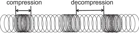

I'll propose a new idea inspired by the everyday slinky. It might be more difficult to perceive exactly what the nesting is, but it might give you a better overall view. We can use a technique similar to the compression and decompression of slinkies:
slinky magic
Take for example the nesting: [a b c d [e f [g] h i] j k l m]. We can visualize it in two dimensions based on nest depth like so:
a b c d           j k l m
        e f   h i
            g
Or alternatively, the inverse:
            g
        e f   h i
a b c d           j k l m
For either of these we need to determine which should be the compression and which should be the decompression (high vs low nests).
We could try both out:
  1. High level is compression, low level is decompression:
    a b c d e f g h i j k l m
  2. Low level is compression, high level is decompression:
Personally I think option two is more visually representative because the large space between the upper levels represents the lack of deeper nests clearly and the condensed space represents the densely packed nests more easily.
Further we could make a formal algorithm. Let's assume input is given as a (value, depth) pair = $(x_i, d_i)$. Let $d_m$ denote the maximum depth of all values in the sequence. For the deepest level, we will pad the elements with 0 spaces, and the highest level we will pad the elements with $2^{d_m - 1}$ spaces on both sides. The only caveat is that we do not pad the left most value on the left and not the right most value on the right. Take the example: [[ab[cd[efg]h][ij]k]lm].
a    b   c  d efg h  i  j   k      l        m
The big problem with this is that it does not guarantee a unique encoding. If you do want a unique encoding with a similar approach but maybe not as visually comprehensive, follow the same algorithm only padding the left side and starting at 1, rather than 0 spaces. So [[ab[cd[efg]hij]k]lm] becomes:
Although keep in mind this only is unique for a sequences of depths, not necessarily unique nestings. For example [ab][cd][ef][gh] would be considered the same as [abcdefgh] because they're all at the same depth.
