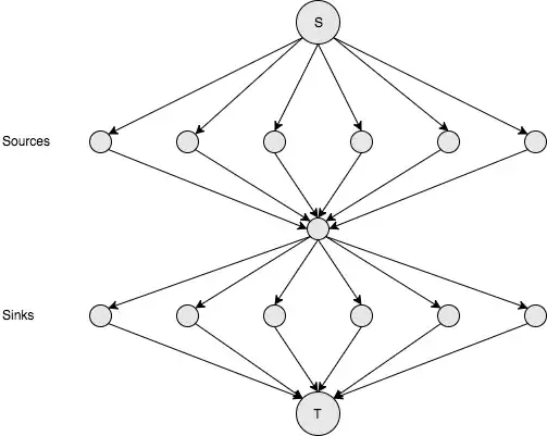

Edit, when I say be smart about the returning traversal, keep in mind a bad case scenario, something like this where all edge weights are equal:
worst-case
There would technically be $6^2$ max weight paths, you could expand this example to get graphs with very large amounts of max weight paths due to combinatorics. So it might be more useful to return the DAG of max-weight paths rather than each individual. Although if you must return individual paths then you might be out of luck, because there are a lot of possibilities.
