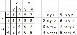

Table of model space
Here I've rendered the formula provided by @rus9384 as a table showing how the model space is covered. The "canonical" unsatisfiable core with only 3 variables would replace the last 2 clauses with $(\lnot x, \lnot y, z)$ and $(\lnot x, \lnot y, \lnot z)$. In this case, all the "blocks" would be "aligned". If you could see this properly in 4 dimensions, it would look like we are building a 4-dimensional LEGO cube by stacking a bunch of 1x2 bricks in the same direction. What @rus9384 has done is take 2 of the "bricks" (which logically form a 2x2 block) and "rotated" them 90 degrees. Of course, this still covers the model space exactly.
Now, to see why an unsatisfiable core might contain more than 8 clauses, we should first think about what a 2-clause looks like. Suppose our formula contained $(x, y)$. This is actually the resolution of 1 and 2, so in a way, you could say that it does contain this 2-clause. And note that 1 and 2 together cover 1/4th of the space. In general, a clause with $k$ distinct variables covers $\frac{1}{2^k}$th of the model space (assuming no tautologies, of course). Thus, to force more than 8 clauses in the Minimal Unsatisfiable Core (MUC), we need to cover less than 1/8th of the model space with one or more of the clauses! Using the formula above, we can do that by introducing a clause with 4 variables, which only excludes 1/16th of the space (e.g., $(x, y, z, t)$ only takes up 1 cell in the table).
"But wait!" you say: "...we were talking about 3SAT! You can't have 4-clauses!" @Max showed that you can run Resolution forwards and backwards to get the desired clauses. So, for instance, we can introduce a new variable, $w$, and add $(\lnot x, \lnot y, \lnot w)$ and $(w, \lnot z, \lnot t)$, which resolve to the 4-clause $(\lnot x, \lnot y, \lnot z, \lnot t)$. If we replaced clause 8 in our formula with this new 4-clause (or its 3-clause "parents"), then suddenly our formula becomes satisfiable, because we have left a "hole" in the model! We would need at least one more formula to patch it up. As you can imagine, one can force a MUC to be larger than any fixed size ($\geq 8$) simply by building it with "blocks" that are arbitrarily small.
"But wait!" you say: "...you already said that all 3-clauses cover 1/8th of the model space! They are all the same size!!!" And indeed that is true. What's really going on is that we are shifting the overlap into other variables/dimensions so that the intersection with the "MUC core", if you will, is less than 1/8th, if that makes sense.
