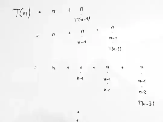

Looking for the pattern (aka "guess and prove") is definitely a workable approach here. Sometimes it's about arranging things in the right way in your head:
(Assuming $T(0) = 0$ as anchor.)
This path leads to an exact solution in terms of "well-known" functions, namely a sum of falling factorials if not a nice closed form. You'd then prove this guess correct using induction, which is elementary here.
