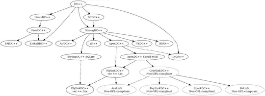

Layered graph drawing
Layered graph drawing is a graph in which the vertices of a directed graph are drawn in horizontal rows or layers with the edges generally directed downwards. . However, graphs often contain cycles, minimizing the number of inconsistently-oriented edges is NP-hard, and minimizing the number of crossings is also NP-hard. enter image description here
source: wikipedia : Layered Graph Drawing
your problem is strikingly similar to the problem of minimizing number of crossings:
