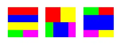

One algorithm I've come across a few times (including a question on Math.SE about the number of ways to do n partitions), is to randomly divide the rectangle in two by drawing an horizontal or vertical line across it, then do the same thing recursively to the resulting smaller rectangles until you get what you want.
The trick here is that although you can get a number of different partitions using this scheme:
binary partitionings
There are some ways of dividing a rectangle into smaller rectangles that this method will never produce:
You can easily see that the divide-and-conquer partitioning will never generate the above, because there's no line that could possibly be the first cut, since no single straight line divides the entire square into two smaller rectangles.
