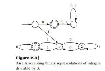

I have found in a book the example of how to make a FA that accepts those numbers that are divisible by 3, that means that n mod 3=0. In the example the author used the binary representation of the number to be evaluated. The resulting automata is:
The states represent the probable remainders, that could be 0, 1 or 2. Some additional explanation is in the following part:
I have tried the following examples to test this automata:
  • If I try to do 6 mod 3 that will result in 0, so I will go from the initial state (upper part of the figure) to the acceptance state, that is because the modulus is 0.
  • If I try 5 mod 3 or 101 mod 11 that would be 2, which in binary is 10. If I want to apply again 2 mod 3. I will end up again with 2 and not reaching an acceptance state. From the upper part I followed the path 1--state 1--0--state 2. What happens there? it just stays in that state 2?
I just do not have a clear picture of how to test this FA for example with an input of 81 mod 3, does it make partial divisions? When I try to follow it I end up in an acceptance state even before finishing to evaluate the remainder.

I believe you are misunderstanding the way finite automata work. A finite automaton accepts a language, i.e. a subset of the finite strings of a given finite alphabet. In your case, the accepted language is the set of strings made of $0$ and $1$ which encode a well-formed multiple of $3$.
Given a string, imagine placing a token on the initial state, then for each character of the string, left to right, move the token along the transition labelled $0$ or $1$, according to which character you read.
After having consumed each character of the string, the automaton accepts if and only if the token is on one of the accepting states.
Considering your automaton, intuitively, the top three states determine whether the string encodes a well-formed number (i.e. a string that starts with $1$ or is exactly $0$, for instance, $1000$ is valid, but $000$ isn't) while the bottom three determine whether or not it is divisible by $3$ using elementary number theory.

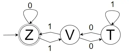

We want to design a Deterministic Finite Automaton (DFA) that accepts Binary Representation of Integers which are divisible by 3.
Now, by accept, in layman terms, we can say that when we are done with scanning string, we should be in one of the multiple possible Final States.
More Formally, Let $w = a_1a_2…a_n$ be a string over the alphabet $Σ$. The automaton accepts the string $w$ if a sequence of states, $r_0, r_1, …, r_n$, exists in $Q$ with the following conditions:
  1. $r_0 = q_0$
  2. $r_{i+1} = δ(r_i, a_{i+1})$, for $i = 0, …, n − 1$
  3. $r_n \in F$
In brief, A word $w=a_{1}a_{2}...a_{n}\in \Sigma ^{*}$ is an accepting word for the automaton if $\overline {\delta }(q_{0},w)\in F$, that is, if after consuming the whole string $w$, the machine is in an accept state.
Approach : Essentially, we need to divide the Binary Representation of Integer by 3, and track the remainder. If after consuming/scanning [From Left to Right] the entire string, remainder is Zero, then we should end up in Final State, and if remainder isn't zero we should be in Non-Final States.
Now, DFA is defined by Quintuple$/5$-Tuple $(Q,q_0,F,\Sigma,\delta)$. We will obtain these five components step-by-step.
$Q$ : Finite Set of States
We need to track remainder. On dividing any integer by $3$, we can get remainder as $0,1$ or $2$. Hence, we will have Three States $Z, V$ and $T$ respectively. $$Q=\{Z,V,T\}$$ If after scanning certain part of Binary String, we are in state $Z$, this means that integer defined from Left to this part will give remainder $Z$ero when divided by $3$. Similarly, $V$ for remainder $1$, and $T$ for remainder $2$.

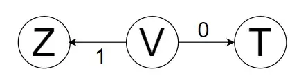

  • Any string in $V$ can be written as $3m+1$
    • On $0$, it becomes $2(3m+1)=6m+2$, which is $3(2m)+2$, state $T$.
    • On $1$, it becomes $2(3m+1)+1=6m+3$, which is $3(2m+1)$, state $Z$.
      [If $m\in \mathbb{Z}$ (Set of Integers), then $(2m+1)\in \mathbb{Z}$]

Hence, the final DFA combining Everything
To Test $6$, which in binary is $110$
  • On $Z$, scan $1$, go to $V$.
  • On $V$, scan $1$, go to $Z$.
  • On $Z$, scan $0$, go to $Z$.
String Consumed. We are in $Z\in F$. Hence $110$ accepted.
To Test $5$, which in binary is $101$
  • On $V$, scan $0$, go to $T$.
  • On $T$, scan $1$, go to $T$.
String Consumed. We are in $T\notin F$. Hence $101$ rejected.
To Test $81$, which in binary is $1010001$
  • On $T$, scan $0$, go to $V$.
  • On $V$, scan $0$, go to $V$.
String Consumed. We are in $Z\in F$. Hence $1010001$ accepted.

Hint:
If the remainders of $n$ by $3$ are $0, 1, 2$, then the remainders of $n$ followed by zero (i.e. $2n$) are $0, 2, 1$, and the remainders of $n$ followed by one (i.e. $2n+1$) are $1,0,2$.
This explains the transitions between the bottom states marked $0,1,2$.
