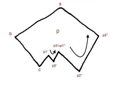

Imagine we have the following star-shaped polygon $P$:
and lets pick the point with the lowest $y$ coordinate of $P$, i.e., $p_2''$. If I'm not wrong, start from there, the steps applied would be:
  1. Pick the next vertex, i.e., $p_3''$.
  2. Lets consider the vertex $a$. We check if $p_2''p_3''a$ is a left or right turn, by using the cross product $(p_3'' - p2'') \times (p_3''- a)$. Since it's a left turn, we pick $a$.
  3. We now consider $p_3''ab$. It's also a left turn, so we pick $b$.
  4. We now consider $abc$. We also have a left turn, so we pick $c$.
  5. Consider $bcp_1'$. It's a left turn, so we alsp pick $p_1'$.
  6. $cp_1'p2'$ is a right turn. Thus we need to remove from the stack $p_1'$. Thus, so far we have included the following vertices in the $CH(P) = p_2'', p_3'', a, b, c, p_2'$.
  7. We consider $cp_2'p_3' = cp_2'p_1''$ (just notation). It's a left turn, so we should include $p_3' = p_1''$. $CH(P) = p_2'', p_3'', a, b, c, p_2', p_3'$.
  8. We now consider $p_2'p_3'p_2''$. It's a right turn, so we should remove all points which create a right turn with $p_2''$, i.e. , $p_3' = p_1''$, but also $p_2'$, because of $cp_2'p_2''$. So, now our final $$CH(P) = p_2'', p_3'', a, b, c, p_2''$$

Graham scan for a convex hull works if you have an ordering of points $a_1,a_2,...a_N$ such that you have a sequence $p_1 < p_2 <...< p_k$ where your convex hull is $a_{p_1}, a_{p_2},...,a_{p_k}$ of which it is not possible to have a winding number greater than $1$.
In general for any polygon $P$ this might not work, but for a star shaped polygon, you could observe that from the point $p$ visible to all points, in counter-clockwise order, will be have the aforementioned property.
