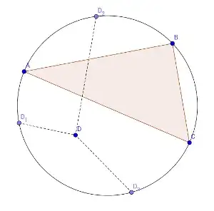

Consider the following situation: given a triangle $ABC$ inscribed in a circle, define $f$ as the product
$$f(P) = d(P, A) \; d(P,B) \; d(P,C)$$
where $P$ is a point on the circle and $d$ are distances between points.
Now, every point $D$ in the interior of the circle can be written as a convex combination of points $D_i$ on the circle:
$$D = d_1 D_1 + d_2 D_2 + d_3 D_3$$ where each $d_i > 0$ and $d_1+d_2+d_3=1$. Then we define $F$ as
$$F(D) = d_1 f(D_1) + d_2 f(D_2) + d_3 f(D_3).$$
A simple visualization of the problem.
The problem I am interested in is: find the choice of points $\{D_1,D_2,D_3\}$ which minimizes $F$ for a given $D$.
