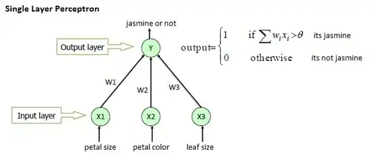

If you construct a perceptron (network) it will be:
$x_1, x_2, x_3$ are input neuron, $w_1, w_2, w_3$ are weights (mimicking the strength between biological neurons) and $Y$ is the output neuron.
You may have a question "Why 3 nodes (or neurons) in input and 1 node in output layer?" so I'm explaining that below:
3 neuron in the input layer as we have 3 features(or inputs).
1 neuron in the output layer as we have 1 class (jasmine or not).
Input layer have 3 nodes which will carry you features to output neuron which will classify if its jasmine or not.

Note: In biology neural network, the neuron get activated when electric impulses exceeds a threshold. Mimicking it, we use a threshold function to active(output one) or not(output zero) a artificial neuron[ threshold value = $\theta$ ].
If the input is a jasmine flower, output neuron will output '1' else '0'.
$ Y = \begin{cases} \text{1,} &\quad\text{if $\sum_{}^{} w_ix_i>\theta $}\\ \text{0,} &\quad\text{else}\\ \end{cases} $
