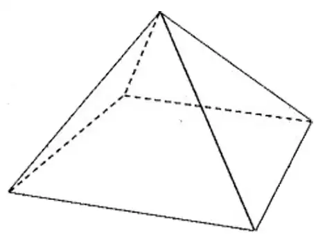

Simple Example
In a wireframe of a square-based Pyramid there are 5 faces - the base is a square and the sides are triangles.
The algorithm should produce 5 sets of edges (since there are 5 faces). One set of edges would contain the 4 edges that make up the square base and then 4 sets of 3 edges for each side of the pyramid.

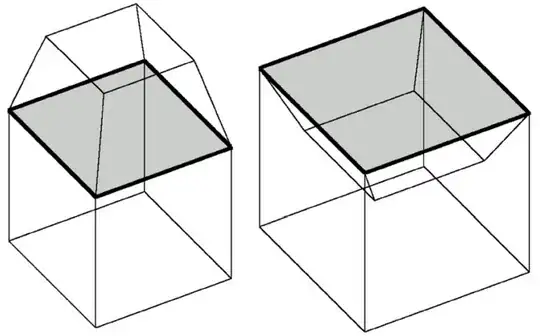

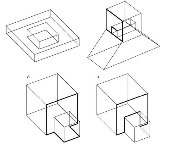

Edge Cases
The highlighted "face" in the following two examples should not be in the solution. These highlighted faces are referred to as "internal faces" (yes, even the highlighted face on the right is considered an internal face in graphics terminology).
Then there are other issues like objects with distinct subgraphs, holes, and ambiguous face loops.
