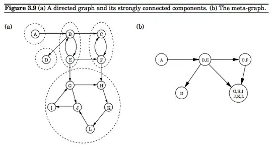

There is not an easy, direct way to pick out a node that is guaranteed to lie in a sink strongly connected component.
I am having trouble to see why. If I apply a explore on any node of the following graph, the first finished node will be one of inside a sink strongly connected component.

It may work for the graph you give, but not for all graphs. Consider a graph with 3 vertices, A, B, and C.
$A \rightarrow B, C$
$B \rightarrow A$
Search on A, exploring B before C, B finishes first but is not in a sink.
Also, note that for the Wikipedia article, the search is on incoming edges, not outgoing, which is why it doesn't need to explicitly transpose the graph.
My intuition for why the reverse topological order is necessary is that given a node $v$ in a strongly connected component $C$, if $v$'s finishing time (denoted in CLRS as $f(v)$) is maximal, than so is $C$'s. However, if $f(v)$ is minimal, $f(C)$ might not be minimal. In order for the algorithm to work without the transpose, at each stage you must be able to choose a node belonging to the SCC with the lowest remaining $f(C)$, which is generally not possible without already knowing what the SCCs of the graph are.
