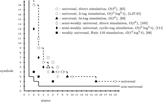

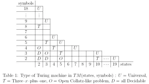

Blank tapes vs arbitrary tapes
As highlighted by Marzio, the question of "decide every N-state Turing machine for every possible input" has already reached the wall basically:
  • 3 states: decidable
  • 4 states: unknown believed to be decidable
  • 5 states: a Collatz-like problem
  • 10 states: Collatz itself
  • 15 states: Turing machine simulation (Universal Turing machine)
These numbers were extracted from the following answers which give their references:
Also note that the second image is already outdated:
  • as we have a 15-state universal machine as per first image, just it simulates slower than the previously known 19-state one
  • BB(5, 2) was settled by the Busy Beaver Challenge project, actual Collatz-like is at BB(6, 2)
While those could potentially be reduced slightly if an even smaller machine is found, we are already basically bricked at 5 states in terms of what we can prove.
This is what makes the blank-tape only problem more compelling to me. It is fundamentally simpler, as we don't have to consider infinitely many inputs for each machine: one machine, one input, can I decide it.
As a result, we get to zoom in much more, and the boundary between decidable, hard maths problem and undecidable has humongous gaps that beg to be improved. Notably, given that we got away with only 30-40 manual proofs for BB(5), it is not clear if BB(6) will present fundamentally hard maths problems or not. What about BB(7)? And so on. Because now we are at BB(15), which is a monumental gap away from BB(5).
